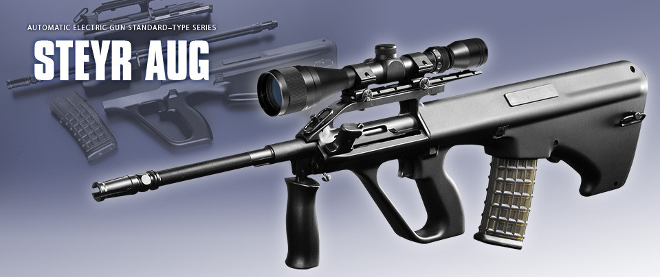

Hopuptype: Adjustable Hop Up
Weight: 3300 grams
Length: 805 mm
Width/Height: 32 mm
Pipelength: 510 mm
Velocity: 88 (280) m/s (fps)
Capacity: 80 rounds
One of the first guns designed to be user-friendly, the Steyr AUG was designed for firing both left or right-handedly. The body of the gun is made of plastic accurately depicting the plastic body of the real gun and the construction is remarkably solid. The Steyr AUG is one of the most popular of Tokyo Marui’s guns in terms of solid construction. Another great design quality is the fact that the Steyr AUG is a bull-pup weapon. This makes for a longer inner barrel and superb accuracy and power. Yet another awesome design feature is the selecting between semi-automatic and fully automatic. You will quickly notice the lack of a selector switch on the Steyr AUG, instead the selection is determined by the amount of pressure placed when pulling the trigger. Pulling the trigger half way will produce a single shot, while pulling it back all the way will unleash a torrent of airsoft pellets. A raised rail on the top of the gun allows for the attachment of a large number of scopes, sights, or lasers. No additional scope mount base is needed. Steyr AUG is one of the world’s most superbly designed guns made into an equally superb airsoft AEG. To adjust the hop-up unit the gun’s cocking mechanism must be pulled, which slides open the shell ejector port. Inside is the hop-up unit.

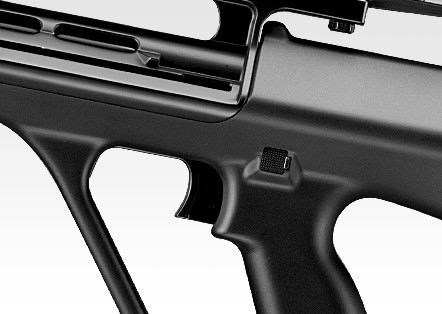

The hammer unit is made as a separate assembly and almost entirely of plastic (including the hammer itself). Only springs and pins are steel. The hammer unit is located in the butt and is linked to the sliding trigger by the dual trigger bars. The safety is of the cross-bolt, push-button type and located above the pistol grip. There&#39s no separate fire mode selector on the AUG rifles. Instead, the trigger itself is used to control the mode of fire. Pulling it half the way back will produce single shots, while the full pull will produce automatic fire. The enlarged triggerguard encloses the whole hand and allows the gun to be fired in winter gloves or mittens.

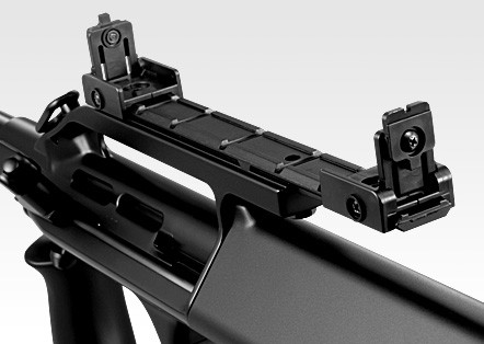

The standard sighting equipment of the Steyr AUG rifle is the 1.5X telescope sight, with aiming reticle made as a circle. This circle is so dimensioned so its visible inner diameter is equal to the visible height of the standing man at 300 meters range. The adjustment knobs on the sight are used only for zeroing. The sight housing, which is integral to the receiver on the AUG A1 models, also features an emergency backup iron sights at the top of the telescope sight housing. Some early production AUG rifles of A1 pattern were fitted with receivers that had an integral scope mounts. On the AUG A2 models, the standard scope mount can be quickly removed and replaced by the Picatinny-type mounting rail.

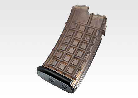

The AUG is fed from the detachable box magazines, that hold 30 (standard rifle) or 42 (light machine gun) rounds. The magazines are made from semi-translucent, strong polymer. The magazine release button is located behind the magazine port and is completely ambidextrous.
