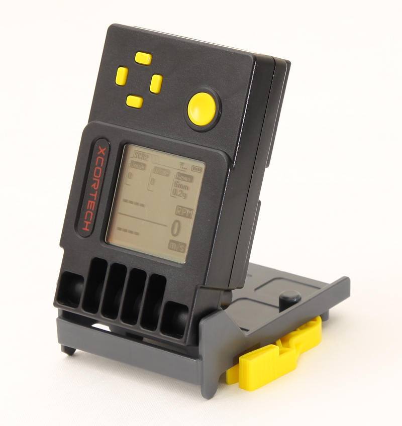

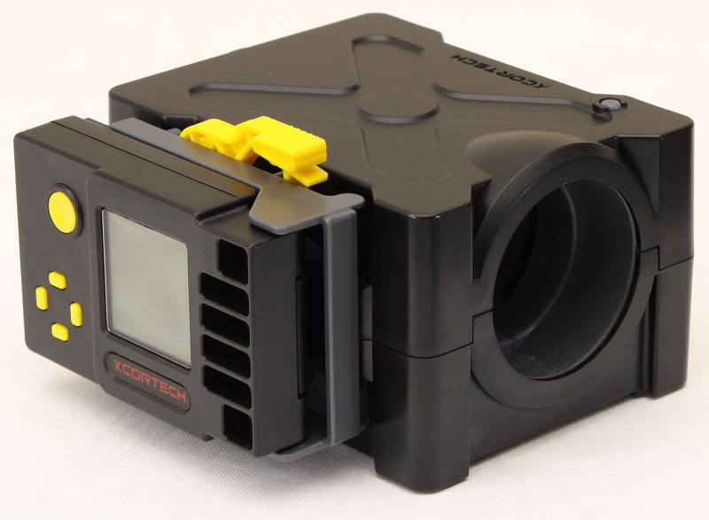

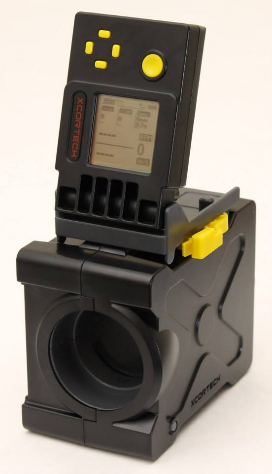

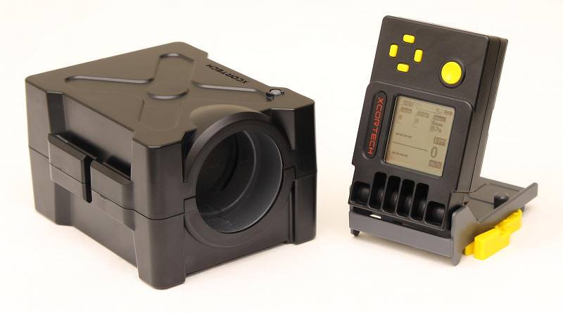

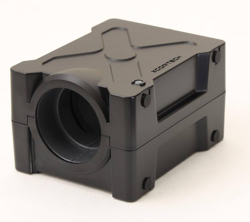

A newest Xcortech Chronograph X3500 derived from 10 years of accumulated
Xcortech technologies. The X3500 provide easy to use, high accuracy, wide shot
area with Statistical Analysis. X3500 is re-design from X3200 to enhance
Chronograph with wireless, shot memory, external power input, multi-screen
show information and auto rotate screen.
X3500 Product Features:
Measures Muzzle Velocity from 30 m/s ~ 400+ m/s (90 ft/s ~ 1200+ ft/s).
Separate display unit and chrono unit
Display unit is capable attach to tactical rail
Display use Dot MATRIX LCD with backlight
Memory Slots for various ammo weight and caliber
Shot memory log velocity and ROF (Rate of Fire)
Calculate MAX, MIN, E-S (Extreme Spread), AVG, S-D (Standard Deviation) by
shot memory
Energy Per-Unit Area Calculation
Extra-large tube diameter (38mm)
Use AA and AAA battery
Chrono unit support external power (Micro USB)
Tripod Ready mounting holes (Screw for standard camera / camcorder tripods)
X3500 Product Specifications (Display unit)
Shot memory: 25 logs.
Ammo parameter setting: 6 memory slots.
Display UNIT:
ROF: RPM, RPS
Velocity: m/s (Meter Per Minute), ft/s (Feet Per second).
Rotate display: LOCK, AUTO.
APO (Auto Power Off): 5, 10, 30, 60 minute.
Display Backlight :
Type: Auto, always off, always on.
Brightness: High, Middle, Low.
Reverse display: YES, NO
LCD contrast: level 0 ~ 15.
Battery : AAA Battery x 2
Weight: 72g
X3500 Product Specifications (Chrono unit):
Muzzle velocity range: 30~400+ m/s
ROF range: 100~6000RPM
Muzzle energy range: 0.01~9999 Joule
Battery level display: Led light Green through Amber to Red.
Auto power off: 1 minute after display unit shut down.
External power: 5V via micro-USB connecter.
Battery: AA Battery x 2
Tube diameter: 38mm.
Weight: 200g
Size : L x W x H = 108 x 87 x 66 (mm)
Size : L x W x H = 84.5 x 59 x 31 (mm)
