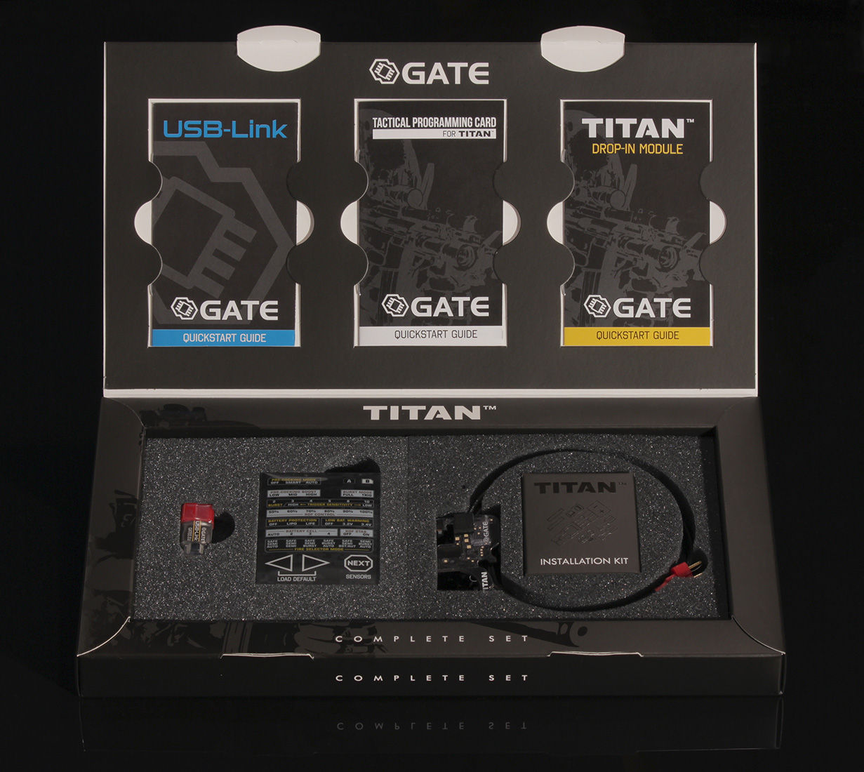

Kit contents:
TITAN Drop-in Module (front wired)
TITAN Tactical Programming Card
USB-Link for GATE Control Station™ App
Installation Kit
Quickstart Guides
