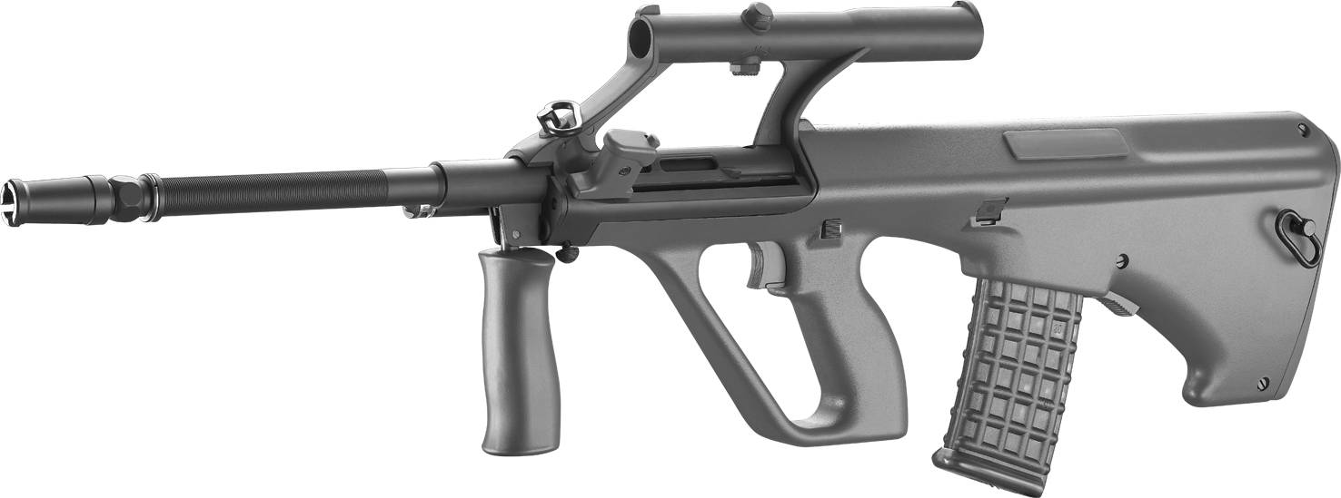

AUG A2 Military
200.00
Κωδικός προϊόντος: JG-0449A Κατηγορία: Brand: Jing Gong (China)
Gun propulsion: electric
The replica is made of: ABS: body (in olive color),
metal: flash hider, barrel, gun breech mechanism cover, and scope,
synthetic material: folding tactical handgrip.
Velocity (FPS): 350 fps
Magazine/Clip Capacity: 330 BB’s (Hi-Cap)
Gun lenght:  81,5 cm
Gun weight: 3200 g
The scope is not an imitation and has a constant zoom of 1,5x.
Replicas come from the third generation of JG models. Their gearbox’s parts are strengthened.
Additional information / Other information:
Fire modes: single, auto
Hop-Up: Yes, regulated
Trigger lock: Yes
Gun set include:
– Steyr AUG Military [JG0449A]
– magazine
– battery 8,4V 1100mAh Ni-Mh
– battery charger
Real Steel
Caliber: 5.56mm NATO (.223rem)
Action: Gas operated, rotating bolt
Overall length: 805 mm (with standard 508 mm barrel)
Barrel length: 508 mm (also 350 mm SMG, 407 mm Carbine or 621 mm LMG heavy barrel)
Weight: 3.8 kg unloaded (with standard 508 mm barrel)
Magazines: 30 or 42 rounds box magazines
Rate of fire: 650 rounds per minute
Effective range of fire: 450-500 meters with standard assault rifle barrel
